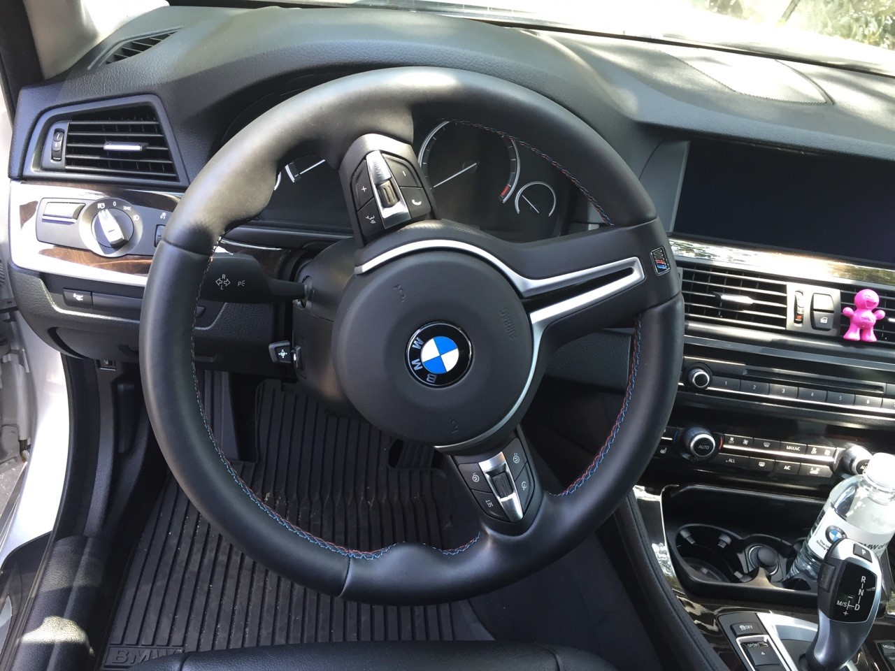

Here you go. The M1/M2 do nothing as I have no Active Cruise Control. All other buttons work. It is heated wheel and I do have heat option as well.
That looks awesome mate. Is it from a 2015 M5? Love the stitching.
Actually it came from 2015 M6 but should be the same between the 2 models.
