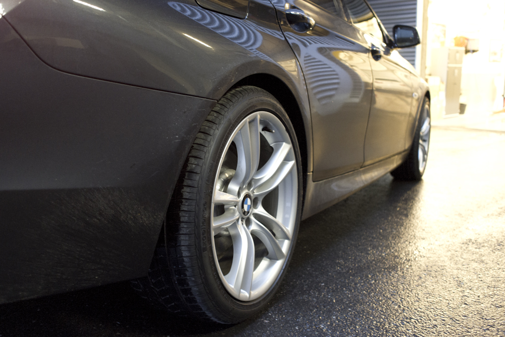

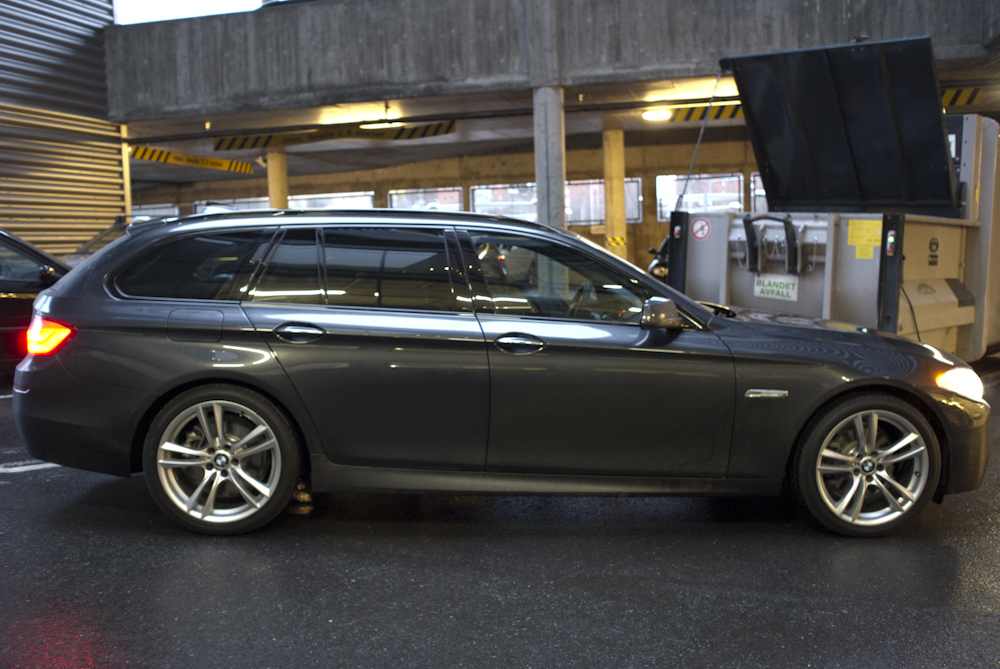

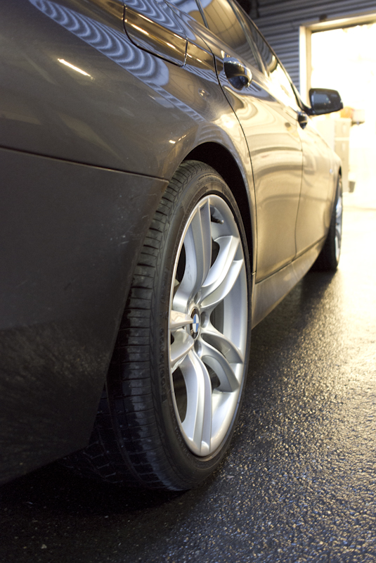

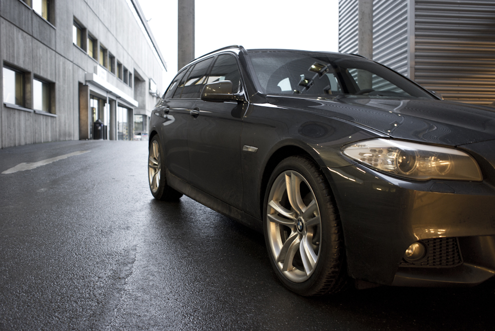

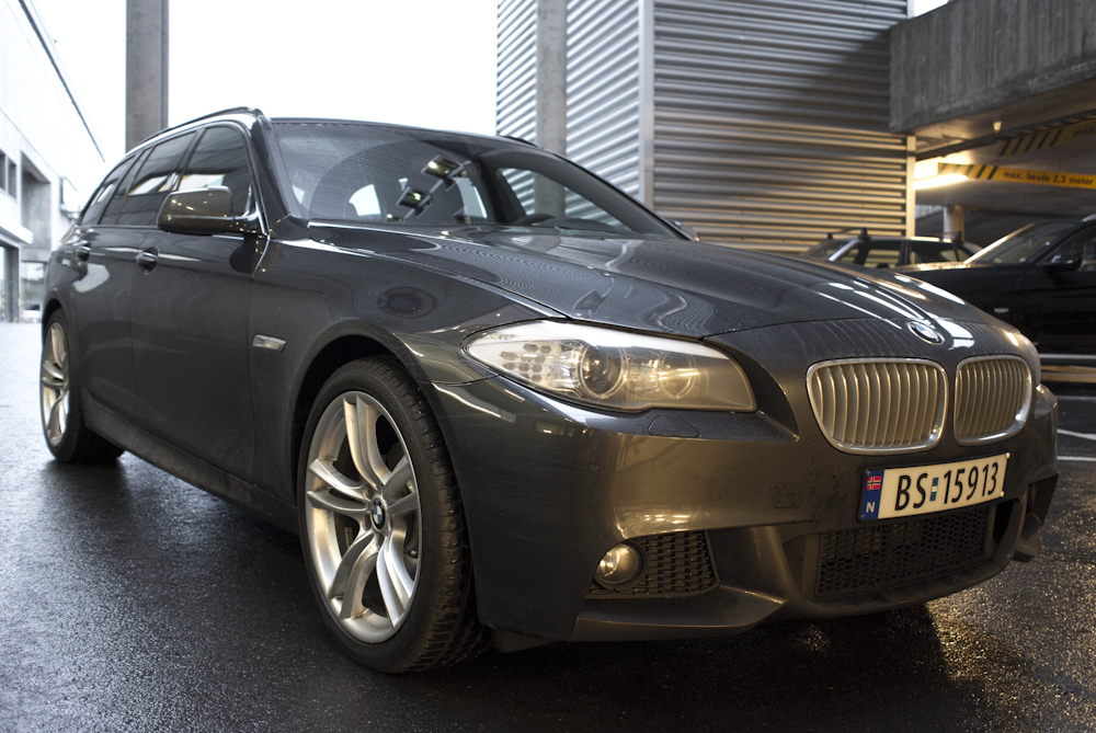

Hi,
I got to try on a set of 20" M-sport 303s which is for the 7 series, on my F11 today. I love these wheels, but needed to check if it was possible with the offset of the wheels.

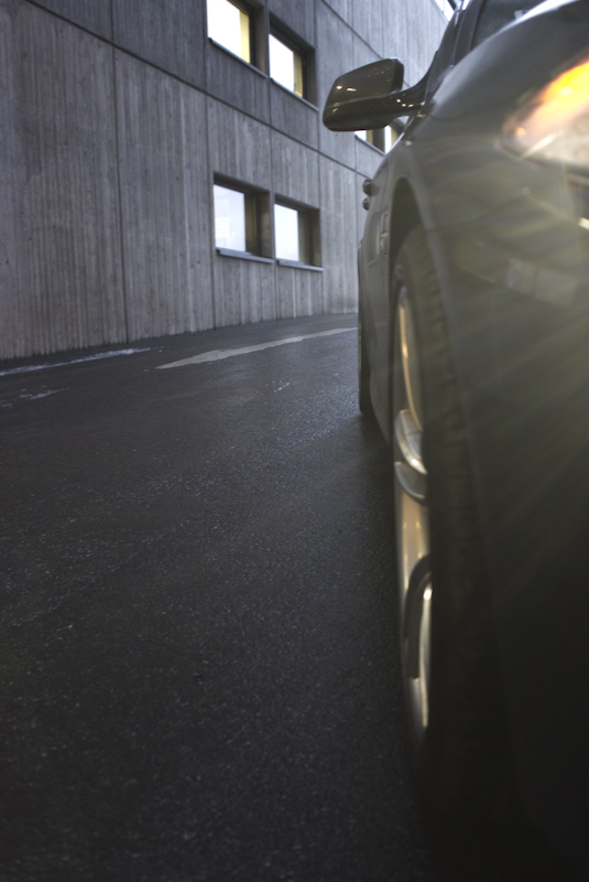

I think the rear looks perfect! What do you guys think? Does the front wheel stick out too much?
FYI the tyres on these wheels are for the 7 series, so too much rubber.
They are 245/40/20 (front) and 275/35/20 (rear)
On the 5 series they should be:
245/35/20 (front) and 275/30/20 (rear)
Question: Do you think I should try out a 235/35/20 in front, to keep as much of the tyre inside the fender?
Also; Is it OK to do this. A bit concerned about the fact that these wheels wasn't built for this car. Offsets are off (even though it looks nice).
Is there any other cons for using different offset than the actual fitting of the wheel?
Best
Claus

Wow, I think they look terrific! Really powerful wheels.
But, as You say, there are too much rubber. The diameter of the wheels are too big.
One other consideration with big offset changes are that you change the wheel geometry. I don´t know if it makes any big difference with 8mm / side?

I think this should work and the wheels looks great, of course change the tires to F10/11 size.
The difference in offset is 8mm in the front. ET25 (F01/F07) vs. ET33 (F10/F11)
Also, I think Lacster is running 20x9 ET25 on his F10.
