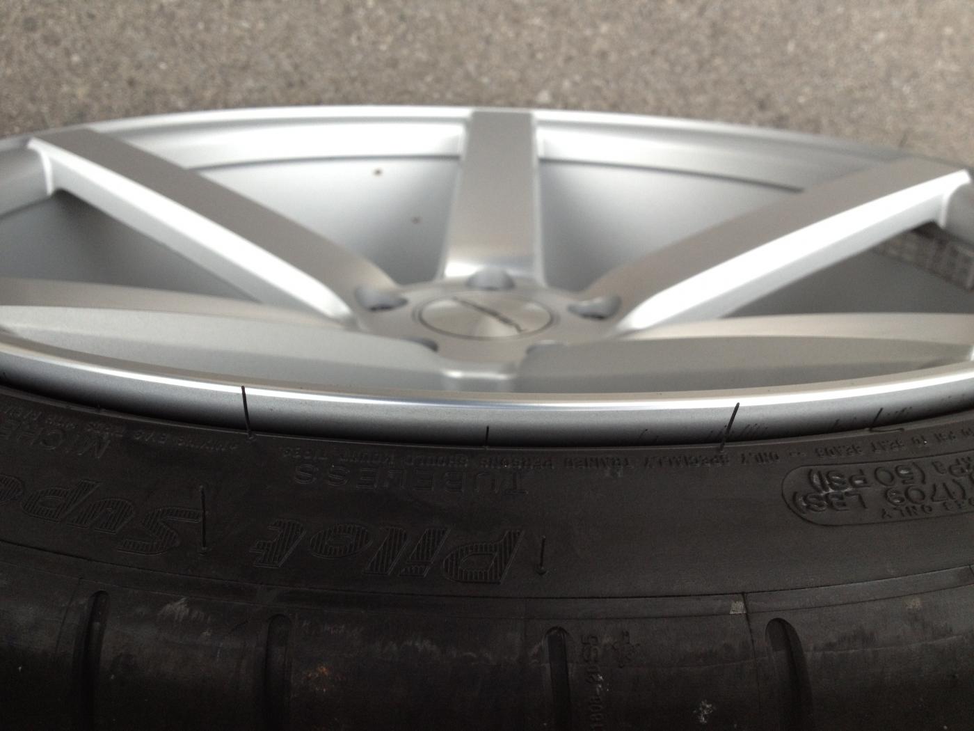

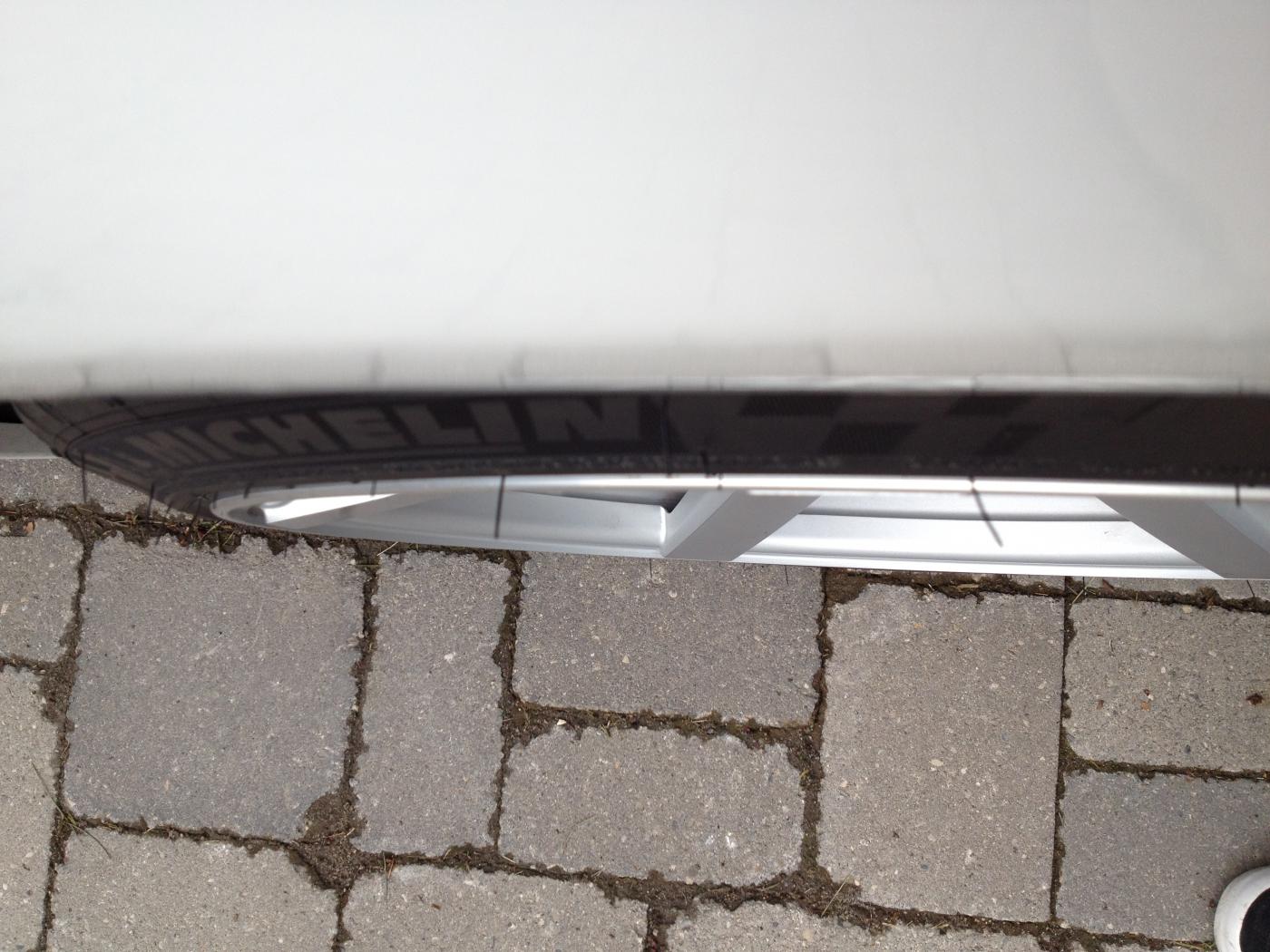

before:
after:
That's a considerable difference!!!
