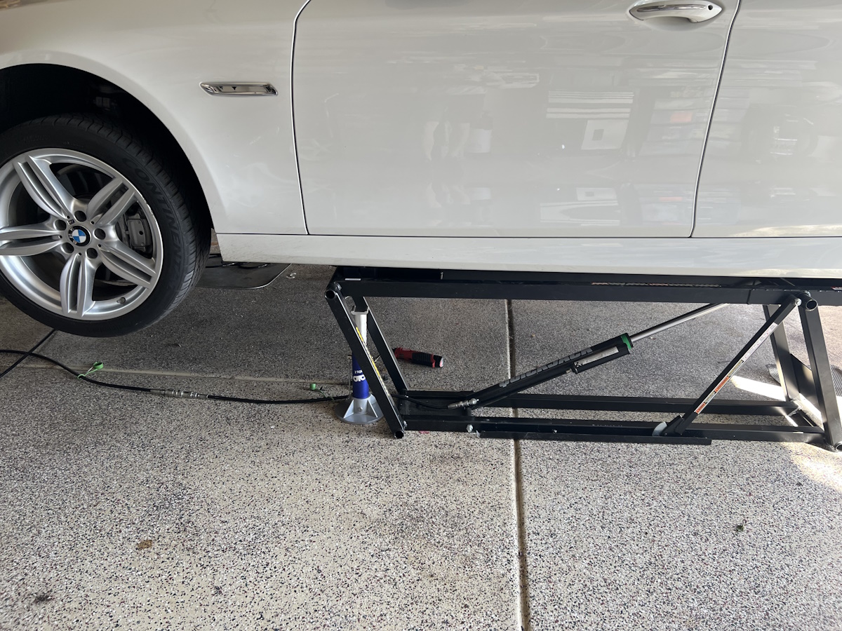

I used a QUICKJACK to do the job and it made it far easier.

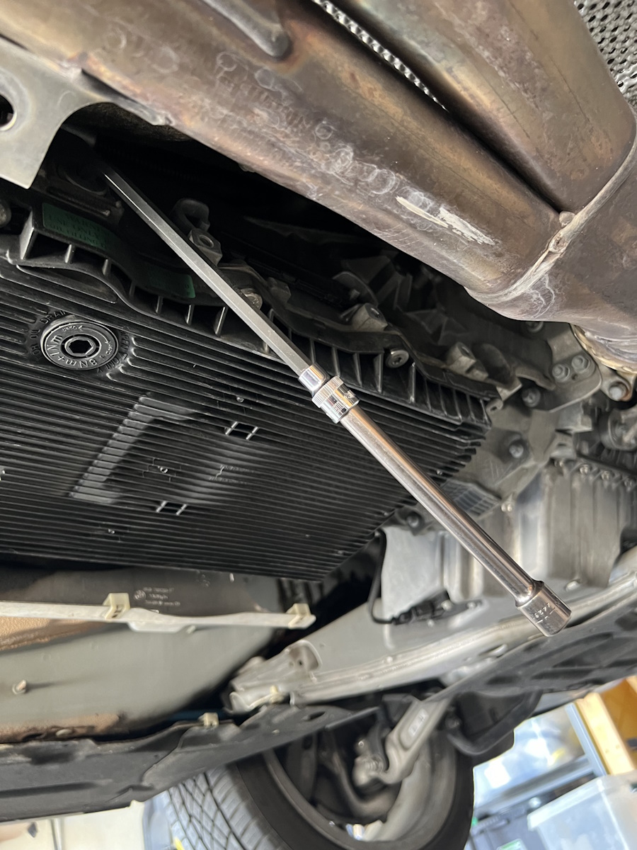

1) Do NOT drain the oil until you've verified you have loosened the fill port. On my 2016, it was both closer to the tunnel and blocked by an exhaust hanger which is not shown on the FCP Euro video. Had I got overexcited and just drained the the oil, I would not have realized a potential issue.

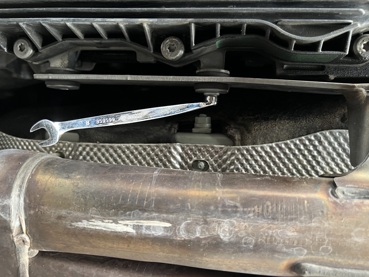

2) You will need to remove the exhaust shield, then the exhaust hanger's shown here. You can use an 8mm wrench on the E-Torx since there isnt enough space to get a socket in. Just go steady. 10mm wrench on the exhaust hangers (do this when the exhaust is cold).
3) When thats off, you can finally get access to the fill port. I did NOT buy the factory tool, I used a stubby allen wrench (Bondhaus on amazon) -- worked great. Just needed to attach an 8mm socket to get enough leverage to crack it loose.

LOL at the extra jack stand under the quick jack. Didn't QUITE trust it, eh?
I dont think theres anything funny about additional safety under the car, especially with the fact I have to start it and run the car? I think my life is worth the 30 seconds of additional backup.

Theres plenty of immature people who truly think it IS funny and "it would NEVER happen..."
I'll admit when I was younger I was more willing to do dumb stuff, but as I have got older, theres more to lose now and the extra 60 seconds for redundancy seems insane NOT to do
