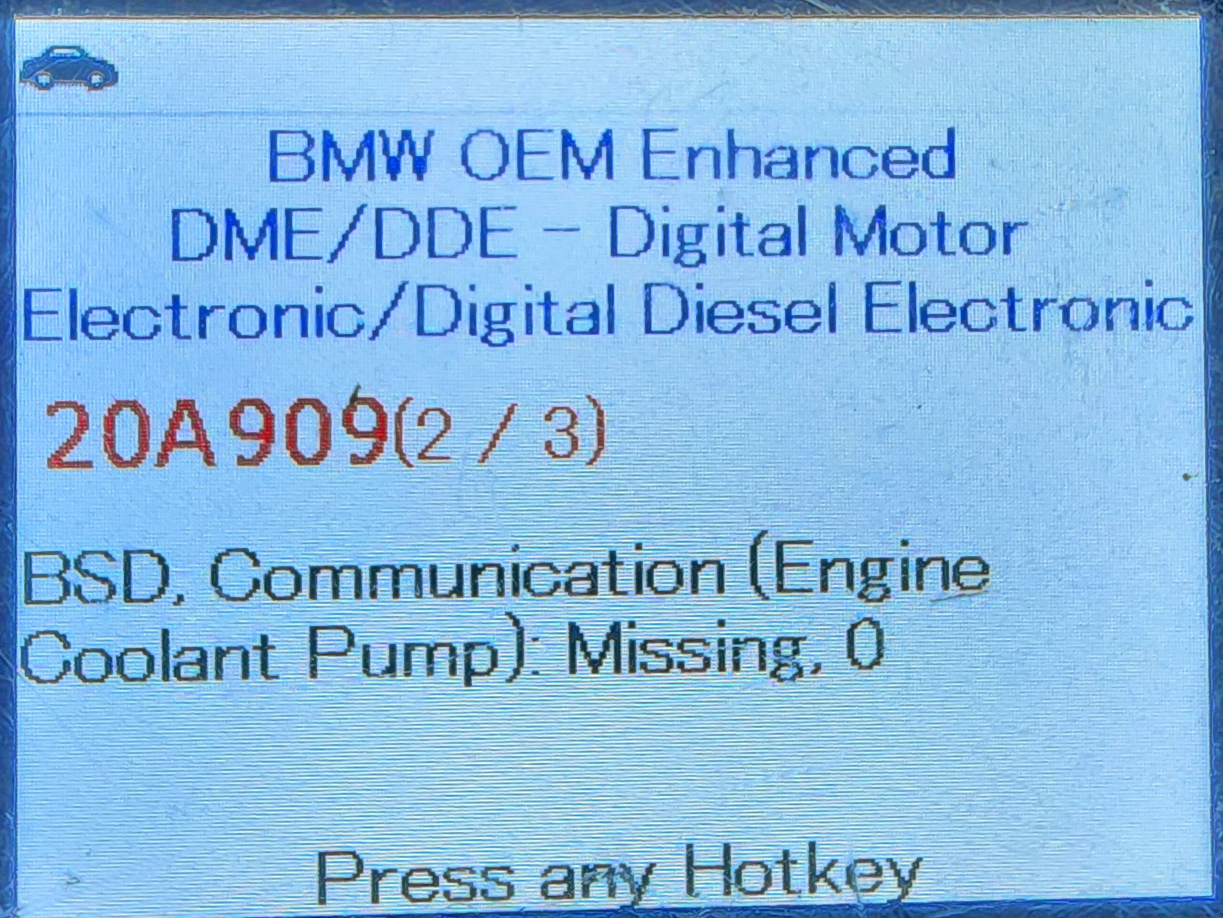

I have a code reader and this is what it has given me: (Note: also see pics attached) Also remember the drivetrain message we are already getting.
*930BB9 - Fault Memory Locked, 0, ZP BMW SRS ACSM Crash Safety Module
*133E10 - DME/DDE Digital Motor Electronics/Digital Diesel Electronic (1of3)
*20A909 - DME/DDE Digital Motor Electronics/Digital Diesel Electronic (2of3)
*420641 - EGS Transmission Control - The DTC Definition is not Available
* Emissions Related Engine DTC's:
No Powertrain DTC's or Freeze Frame Data is Presently Stored in Vehicle CPU
Green: MIS / FUE / CCM
RED: CAT / EVA / 02S / HTR / EGR
