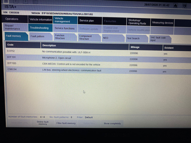

Getting these errors in Ista-d.

So I had to delete the codes with Ista-d. Open Esys and inject the cadf file into the Cmb-Media ECU so that my car would recognize it. Once that was done, I was able to do the normal VO coding and code the related ECUs.
