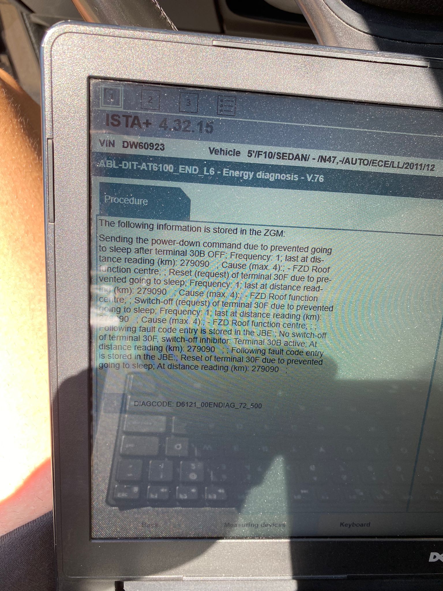

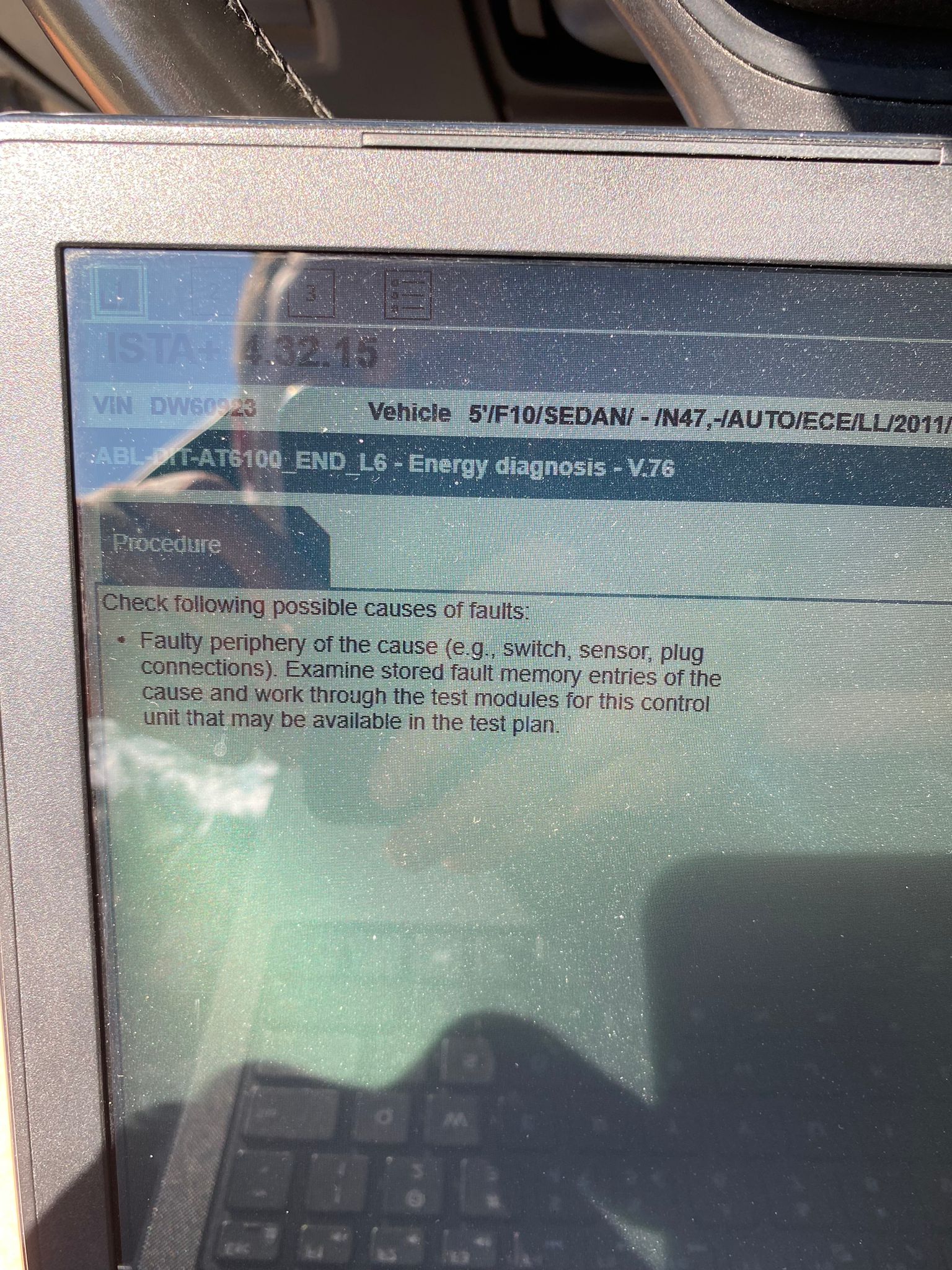

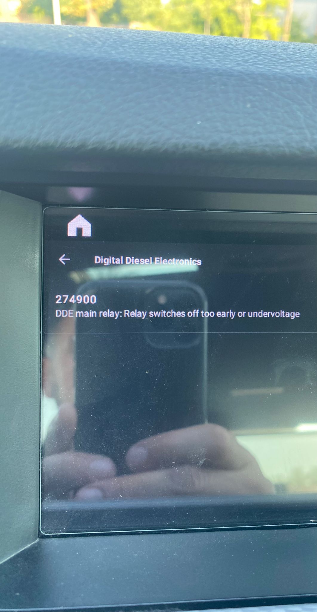

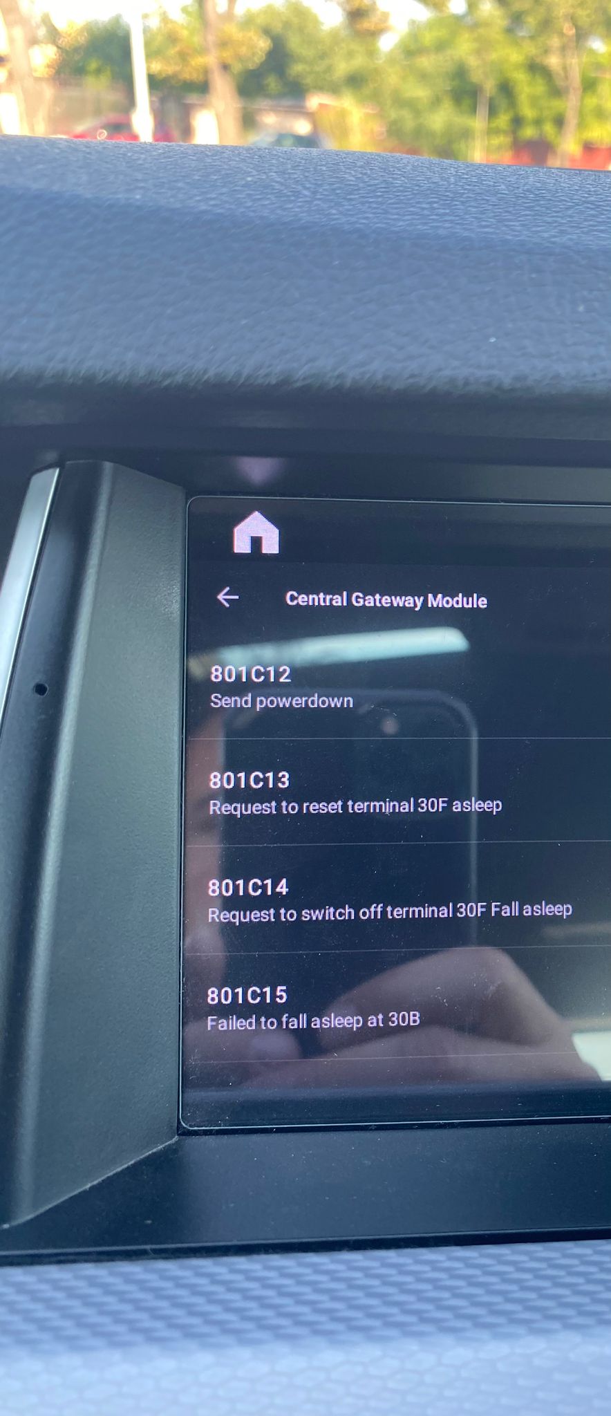

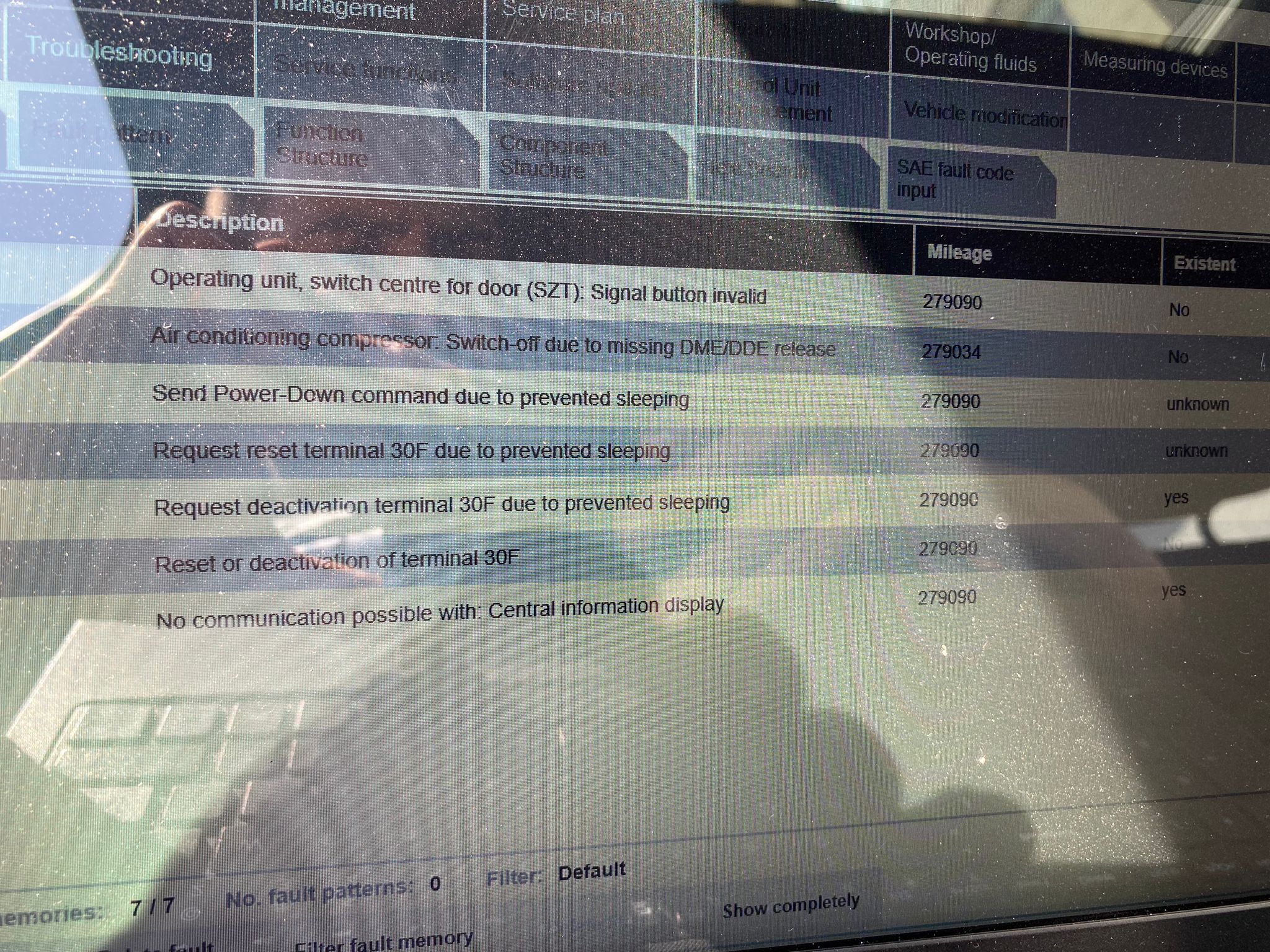

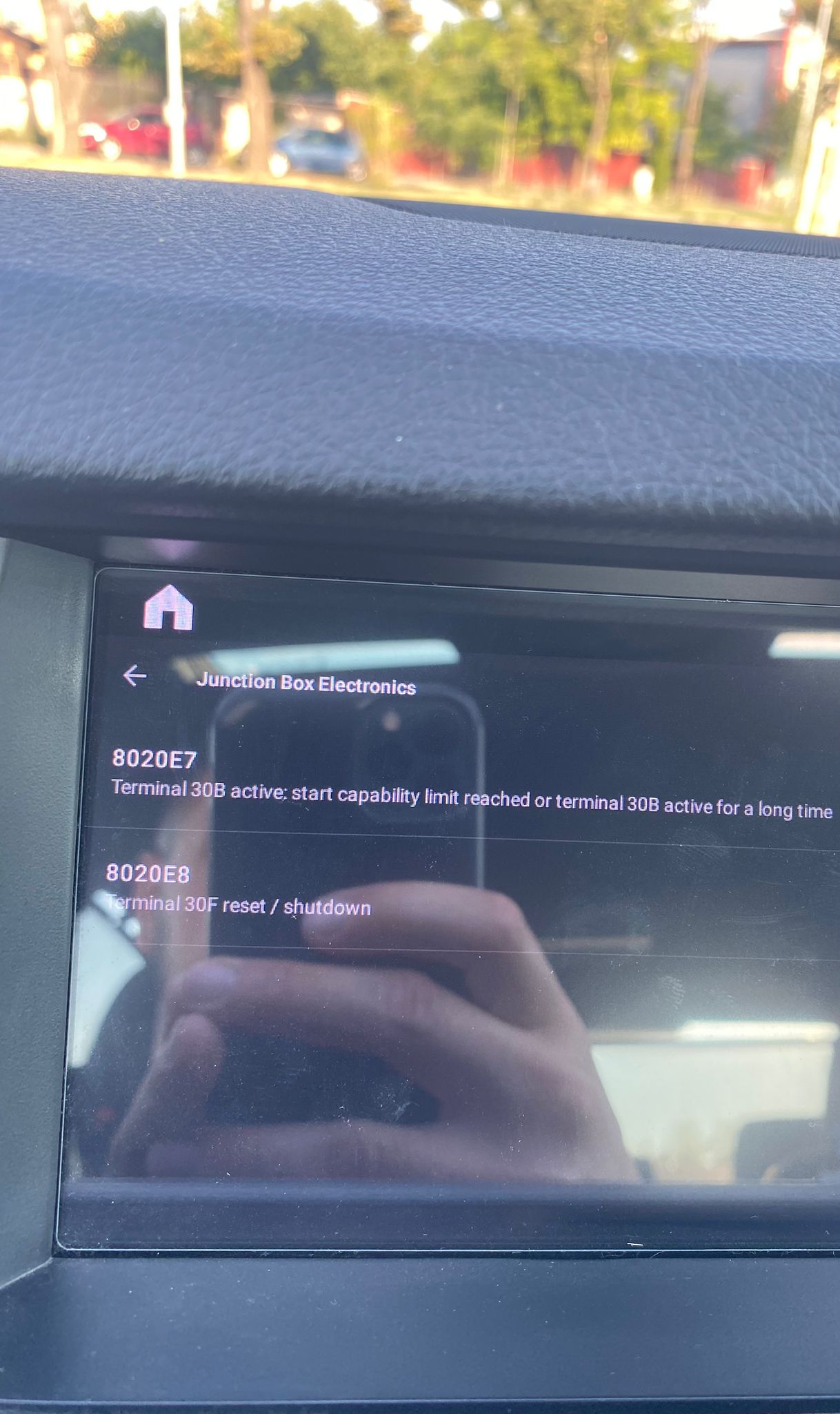

F10 2012, the car fails to fall asleep, checked both relays from glovebox and trunk and they are in good working condition. Performed energy diagnosis in ista and didnt give me accurate info.
The car with all its functions runs perfectly fine, I have no other error codes.
The car does not have confort entry (door handles)

The battery is in good working condition as is just 3 years old and registered.
It got fixed after removing battery terminal for 5 minutes. It seems it was just a bug/glitch most likely in CAS, thanks for the reply though !
