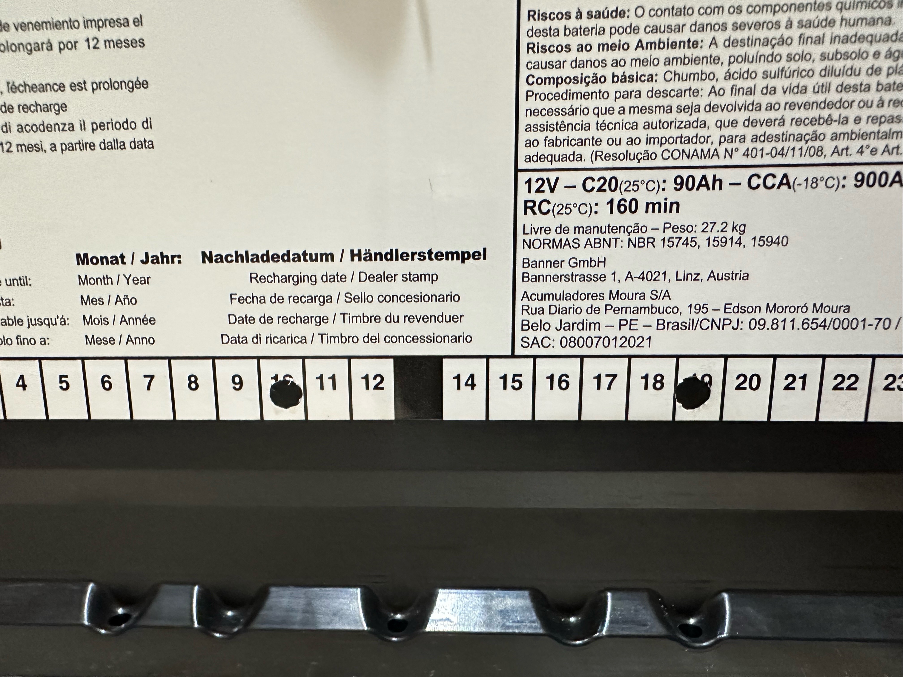

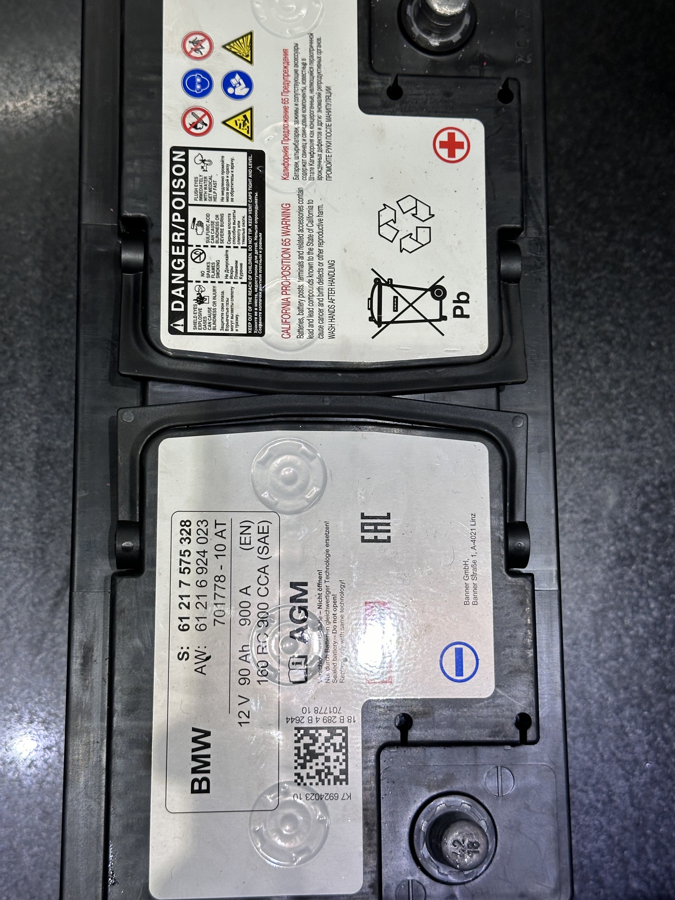

Hello
Thanks for your reply
I checked the date, the battery was replaced at 64740 km, so juste befor I buy it, know it’s around 140500km, I checked the date of the actual battery it was replaced during 10/2019, do you think it is normal that both batteries last less than 5 years?

It is possible for it to fail within 5 years. I’ve seen it fail earlier than that and I’ve seen some that last 10 years.
