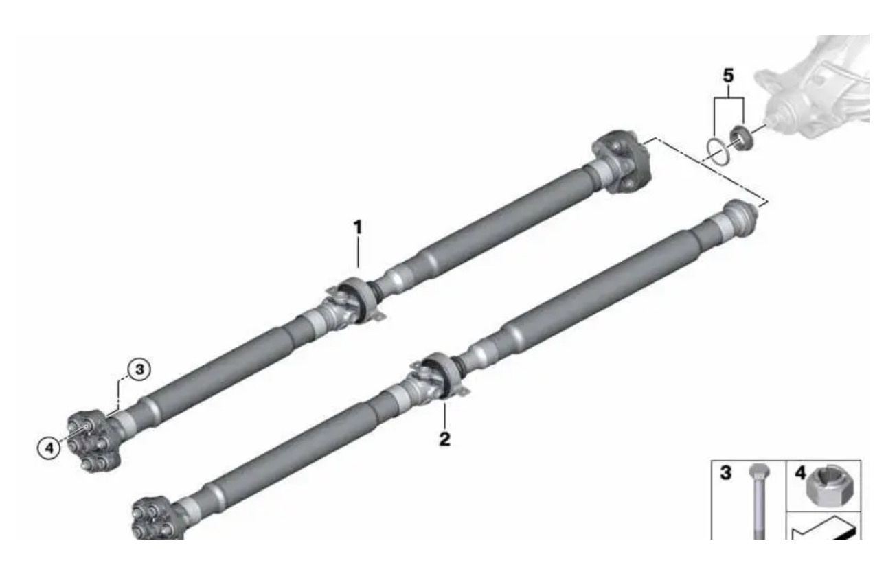

https://www.leebmann24.com/ro/de/col...enkwelle-10122
1- front
10- rear
Bmw Part Number : 26117610061.

There are two versions. Your vehicle most likely have the version that only have one at the front.

Unless it is damaged, I don’t see why you would need to replace the driveshaft. You only need to replace the Flex Joint (Guibo) which you already replaced. The center support and bearing may need attention if it vibrate during acceleration but that’s about it for your vehicle.
