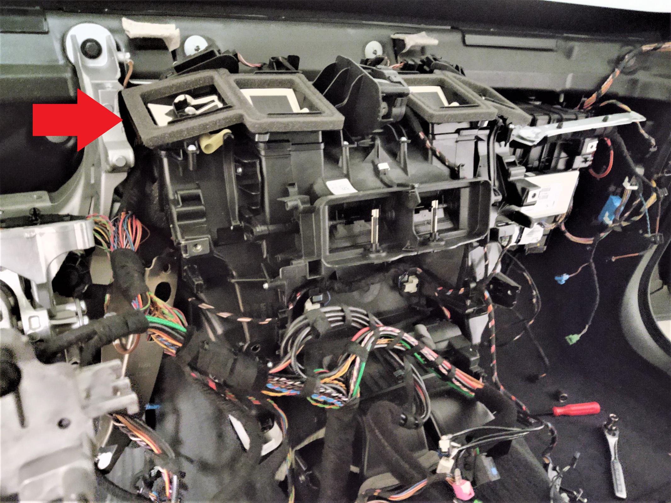

If air is coming of the driver's vent, not sure I agree that the stratification motor needs replaced as you claim.
But, if you want to go to the trouble to do so, it will require the center console to be removed, so that you can completely remove your dashboard.
This is the only way to access the stratification motor on the left top air flap on the air distribution box that provides air directly to the left vent as shown where the red arrow is pointing to in the figure below. The flap motor is on the back side.
It might be easier to run ISTA on your vehicle to pull the codes for your IHKA. If this is too much trouble, providing us with a bit more information of the "issue" you are experiencing with your temperature controls. I could be convinced that a faulty heater valve (remains on even when it's supposed to be closed during A/C use), would allow heat to come out of the vents on the left side of the vehicle, except the center left vent if the thumb wheel is set to "cold" (blue).
BTW, the air flow through the air distribution box pushes air through the A/C evaporator 1st, then through the heater core, which has a left and a right coolant path, so that the heater valve controls independently, left and right.
A faulty heater valve is MUCH easier to replace than a stratification flap motor (what you are calling an actuator motor).
I might be easier to run ISTA on your vehicle to pull the codes for your IHKA. If this is too much trouble, providing us with a bit more information of the "issue" you are experiencing with your temperature controls. I could be convinced that a faulty heater valve (remains on even when it's supposed to be closed during A/C use), would allow heat to come out of the vents on the left side of the vehicle, except the center left vent if the thumb wheel is set to "cold" (blue).
