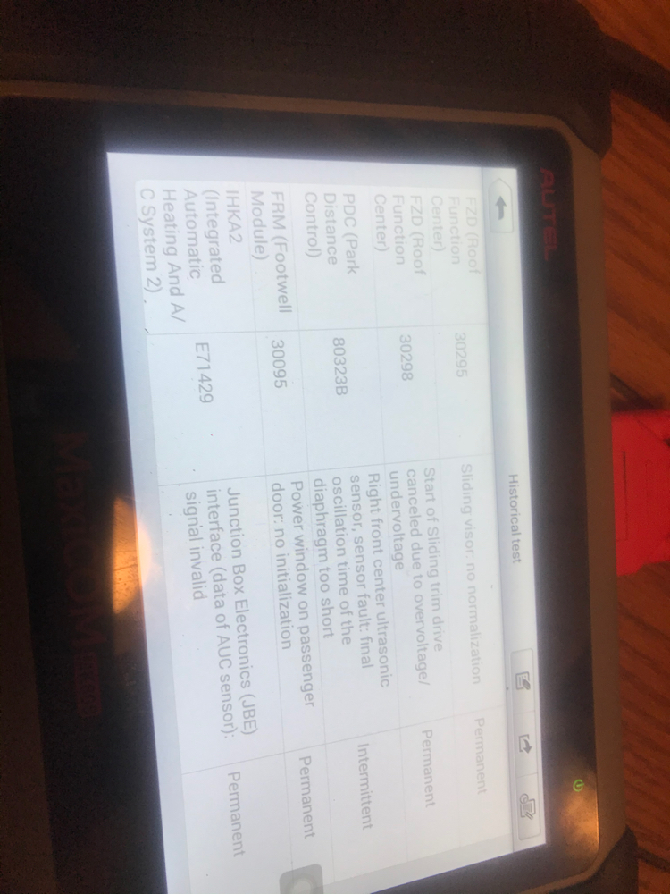

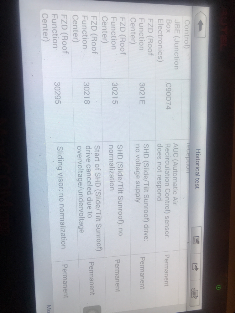

Hello I have 2011 BMW 535i. 05/10 build date.
Having some trouble getting my sunroof working... at all.
Checked and replaced all fuses 58,61,11,182
Tried initialization and nada. Must've held tilt for a whole minute and nothing.
Won't initialize on my autel scanner either..
These are my codes in attachment photos
Not sure if my power window on passenger side has anything to do with it.
Code 30095
Any input will be much appreciated.
Thank you!

can you go into service on your autel?
if u can I'm curious if you can activate the functions thru the tool.
I have autel and was able to then my initiation worked.
hope it works for ya.

Installed new fzd and nothing...
