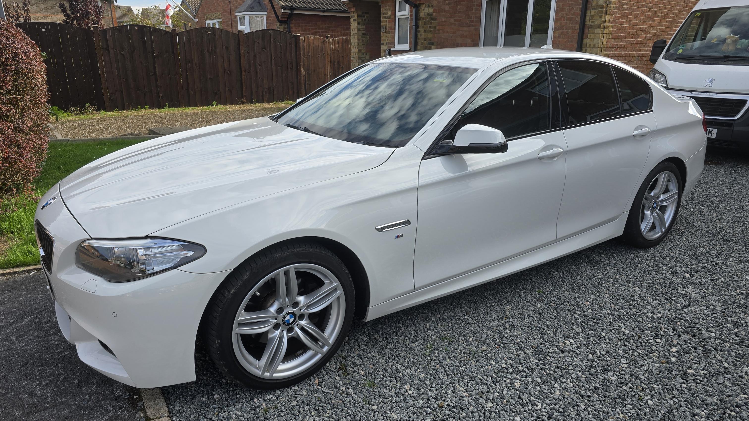

Mines the same, too....
How bizarre this vibration is
Just picked up a pretty mint 520D with 40k miles a couple of months ago and it has exactly the same symptom's.
Running on 19" M-Sport alloys and RFT. Can feel it come in thru the seats around 70mph. I hear a lot about the 19" alloys buckling easy, too. Another thought is the rear tyres being down to the limit.
Well I needed 2 new rear tyres, so decided to buy a set of OE 18" wheels and ditch the RFT, in the search of a little more comfort, so will report back once the wheels have been refurbed and new Goodyear Eagle F1's fitted.
