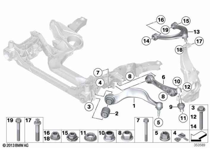

      Yesterday, 03:29 PM   #6
itsnota2ma
itsnota2ma's Avatar
22
63
Drives: 2012 550i xDrive Msport
Join Date: Feb 2019
Location: Milwaukee
Was it number 6 on this diagram? I have the same noise after replaced my struts.
