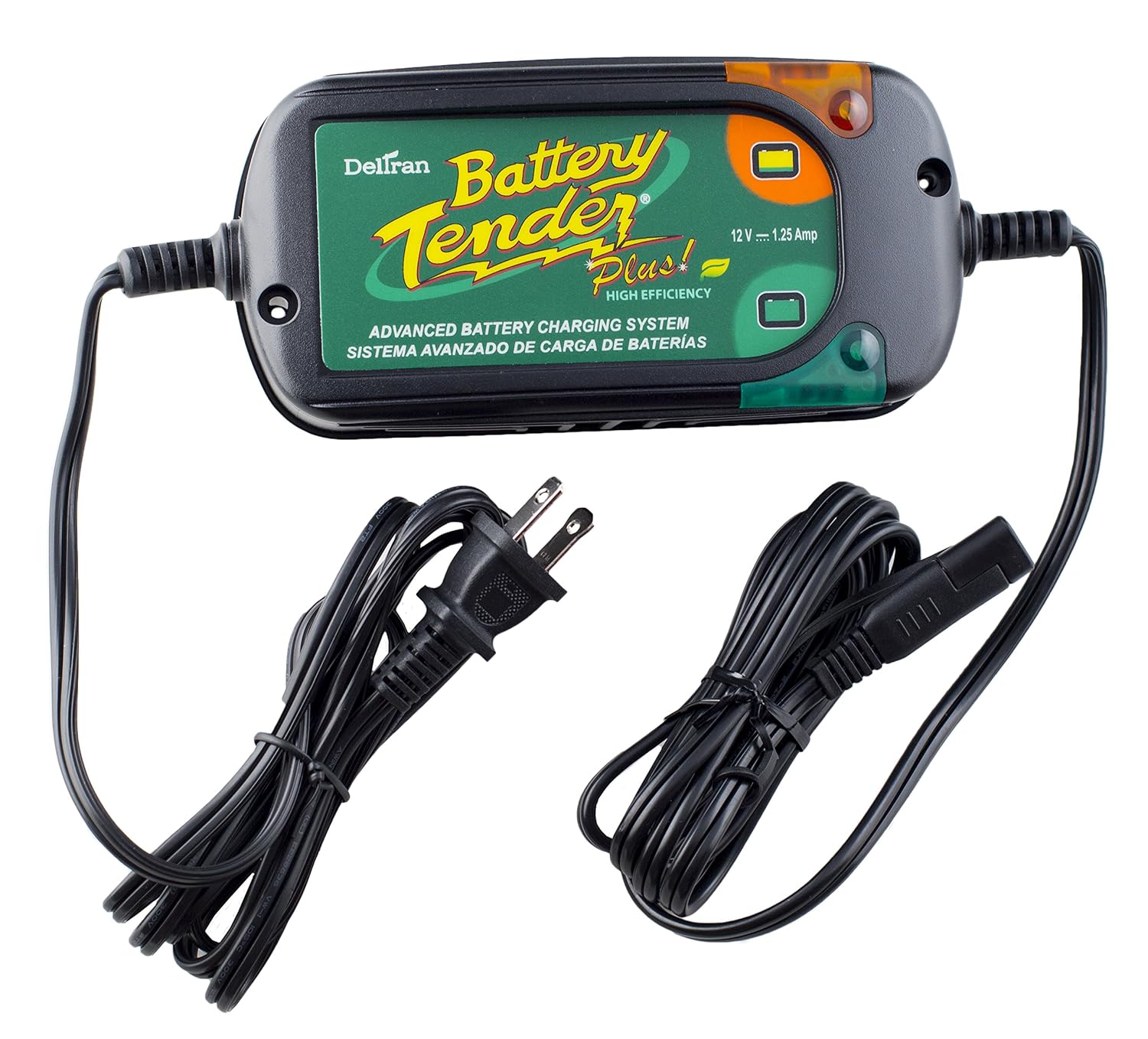

6736
6,246
Originally Posted by Carlos528i View Post
What battery charger do you guys recommend in the under $150 range ?
I bought this one...
      07-15-2016, 08:16 AM   #147
shawnsheridan
shawnsheridan's Avatar
12995
49,210
Drives: 2018 Alpina B6 650ix GC
Join Date: Feb 2010
Location: Houston, TX
For the sake of clarity, this is a Batter Tender, which is a Trickle Charger with added circuitry that monitors the battery and charges only when the voltage has dropped below a preset level, thus preventing overcharging and damage.
It is capable of only 1.25 Amps. It may be fine for Coding, for those who do not want to run their motors, but in no way is it fine for Programming (Flashing), where you really need at least 50.0 Amps.

      07-15-2016, 09:36 AM   #148
Carlos528i
35
Drives: 2013 528i
Join Date: Mar 2012
Location: Marietta, GA
2013 BMW 528i  [0.00]
Yes, I am looking at flashing, most of the 30A+ i've seen are in the $350 plus range.
I might just rent one for the weekend.
