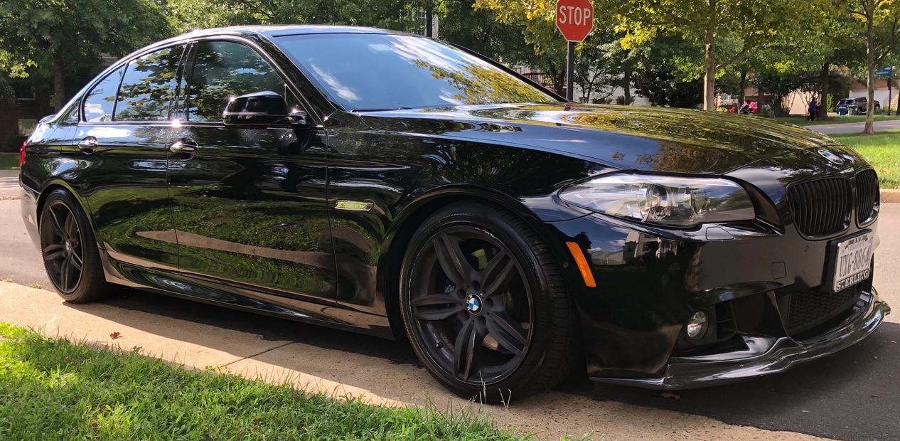

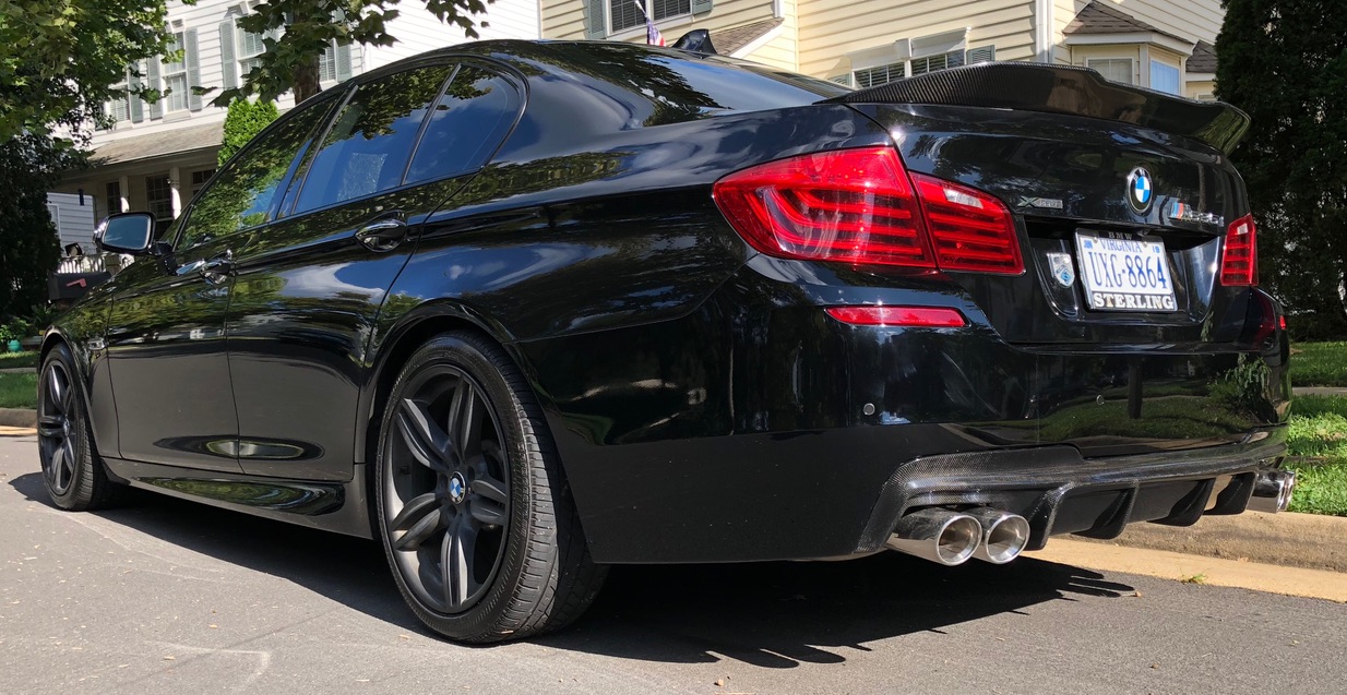

Here are few pics of my car before front lip cracked (and I need to fix scratched up wheels)

told you before but damn I want that wing!!!!
i'd run a splitter under that spoiler
