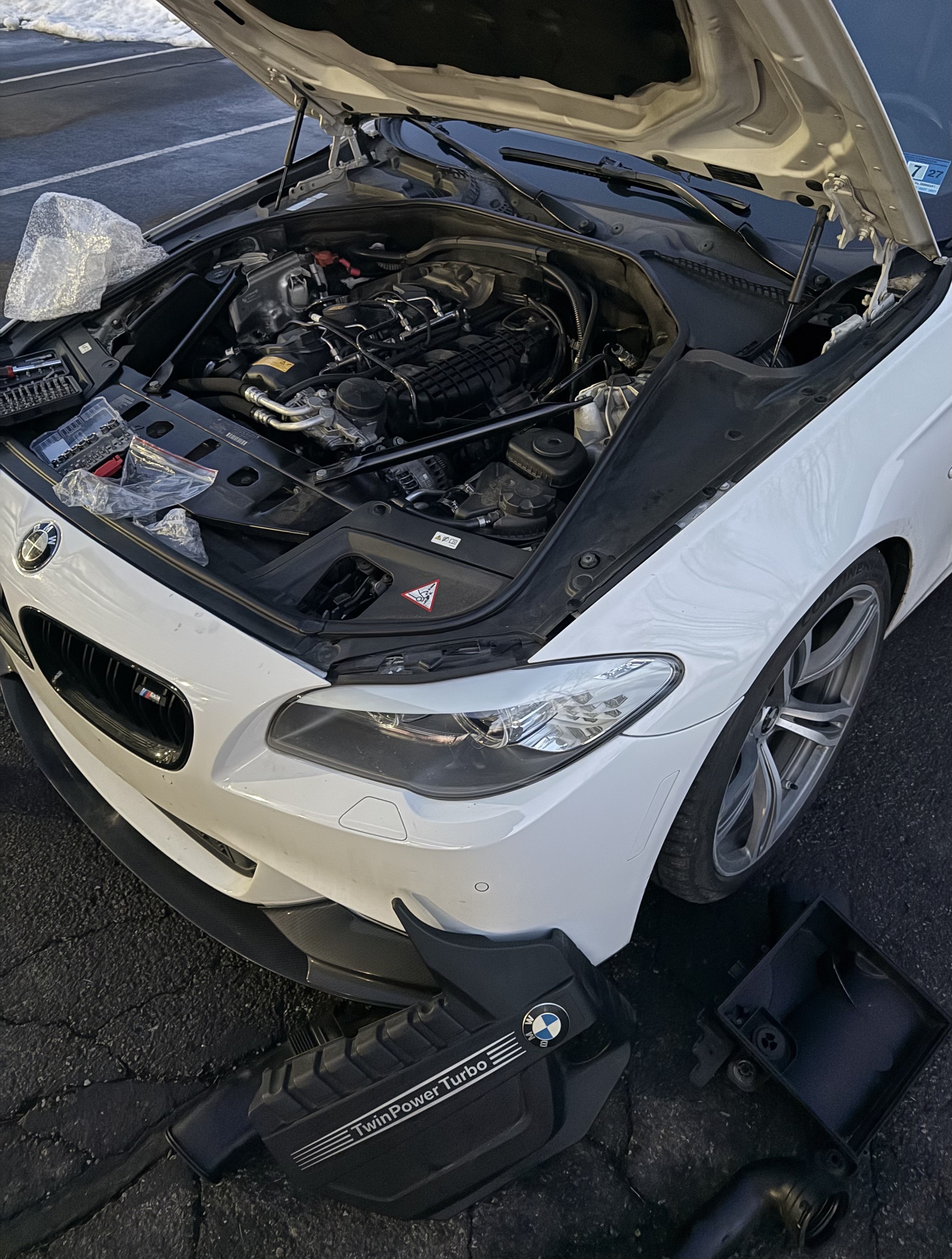

Noticed a small boost leak last week, chalked it up to the plastic chargepipe. Yesterday the car went into limp mode and turned off all boost. Had my FTP aluminum chargepipe in the trunk so I swapped it in the parking lot at work (total pain in the ass by the way, was not as easy as the tutorials made it seem lol). Didn’t fix the issue tho, still had no boost. Couple hours later, found out that one of the vacuum lines going to the boost solenoid were ripped. Replaced that with a new line and the car seems to be running well (fingers crossed) lol.
Hopefully won’t have any more issues 😅 but hey at least I finished the chargepipe install I’ve been putting off lol
