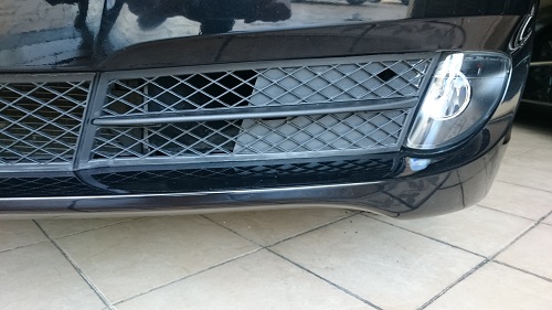

Sorry for the really late post. Got mine installed with Lacster's guide (thank you OP), but it wasn't as easy as i expected it to be. The front bumper needs more tugging to a point where i'm afraid that it would break while trying to unsecure all of the clamps of the original grille. The new grille fits in perfectly and it was very easy to install. In the end it all works out pretty well and i'm very happy with the result
Name:  f10 grill change.jpg
Additionally, i also followed OP's guide on removing the mesh part beside the fog lights, but i took another route of plasti-diping the silver trim instead of painting them. However if you look at the pic, the mesh part of the Indonesian 5 series version, half of the mesh is covered and there's only a single hole where you can slide a finger inside to pull the entire part out. It requires more effort than what the OP said, as the hole makes it alot more difficult to pull the mesh out and as i couldn't apply equal force on all 4 corners, there's a risk of breaking it. So be very careful for anyone who is going to try to take the mesh out but apparently have a similar type of situation. Cheers
