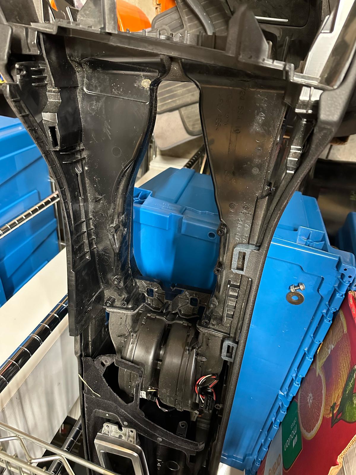

Item 5 in your photo is right where your arm rest is. That part cans be plastic pipe or a blower motor if the vehicle is equipped with 4 zone.
As you can see in my photo, I have a blower in that place. That is not where the cup holder is. It is at the front of the console. That pipe is one piece with the console.

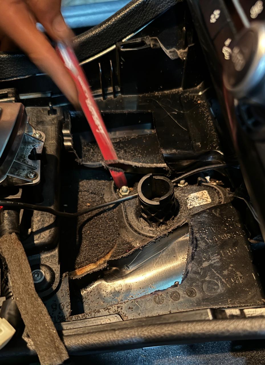

Update
Went with the dremel route.. without a dremel
used a hand saw blade and some sort of shear cutters
At the end didn't put duct tape, just left it open.. still there's a flow of a/c to the back.
No the best job but it's hidden.

Made a template with a piece of paper, marked the side tabs and the cups and transfer it to the ducts, but mostly eyeball it after that..
At the end I thought it was hitting something on the left side, but just needed to push down on the big trim piece.
