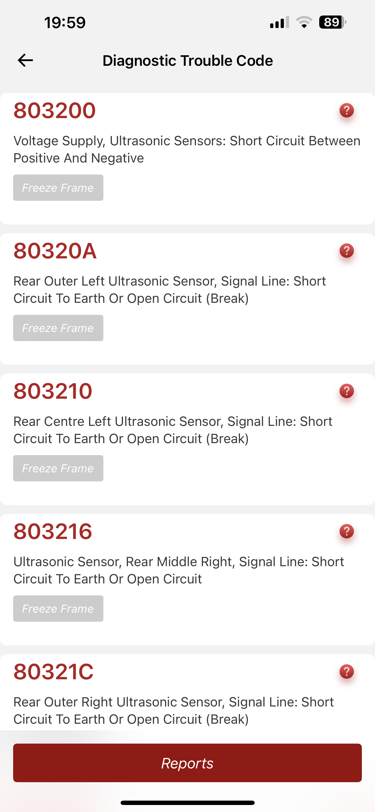

Hello folks,
I`ve a strange issue with my PDC system. The system is showing me that all the sensors have a short circuit or an open circuit (front and rear), and normally, the system can`t be activated. I understand that this could be a wiring issue rather than the sensor, but it looks like a big coincidence that both front and rear sets of sensors have the same issue at the same time. The PDC button blinks when I press it and is also visible from the ISTA or other diagnostic tools that I tried so far. I can also erase the errors temporarily, so I think there shouldn`t be anything wrong with the PDC unit itself. Please, any advice if anyone has experienced a similar issue and fixed it?
Best,
AndiAttachment 1
