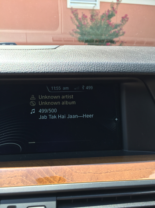

I have a hard drive plug in USB port with 700 video songs, but it will only go up to 500th song. See pic. How do I remove this limitation?
      08-28-2016, 05:33 PM   #181
Stück
Stück's Avatar
891
1,263
Drives: F90 M5C, E46 330i, F15 X5,
Join Date: May 2016
Location: Houston, TX
Browse the directory, it will then find everything on there after.
I have 1500 FLAC files on my USB stick, it sees them all just fine.
